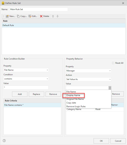

Display name mapping
Until now, if the display name and the username are different, the property value for the file property shows the display name. However, the property value is set to "User" in the Copy Design rule set behavior. With this update, you can choose the property value (User or Display name) you want to display while defining the Copy Design rule set behavior.
For more information, see Copy Design - Action Rule Sets.
