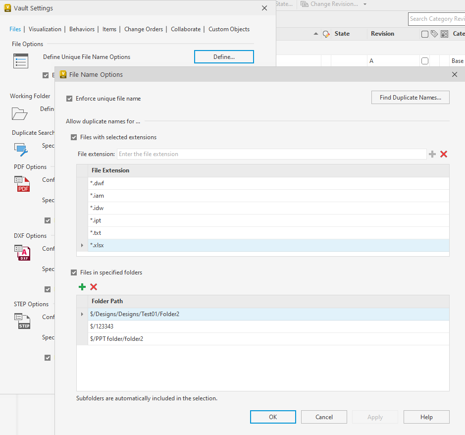

With unique file names enforced, files in the Vault must each have a unique, identifying name. However, depending on the folder structure, the Inventor design data and template location have the same file names. So, if a unique file name check is enforced, those files may fail to check-in.
The enforce unique file name enhancement allows you to enforce unique file names based on the file extension or folder location. You can enable files with specific extensions or files in specified folders to have duplicate file names.
While enforcing the unique file name, you can:
For more information, see Enforce Unique File Names.
