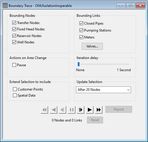

You can trace outwards from a single starting point - a selected node or link - until the tracing tool reaches pre-defined boundary points.
The trace will radiate out from the starting point. Each branch of the trace will stop when it reaches bounding points of the type you have chosen, or the limits of the network.
In addition, you can choose to pause the trace if it crosses the border between two areas (as defined using the node Area Code fields) without encountering a boundary point.
The boundary trace tool uses the Boundary Trace View.
You can set options to control how quickly the trace is displayed, and how often the screen is updated. You can also control a replay of the trace using the buttons at the bottom of the view.
Boundary Trace View

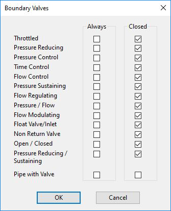

You have a number of options when choosing Valves as bounding points. Valve options are set on the Boundary Valves dialog. Access the dialog by clicking the Valves button on the Boundary Trace View.
Boundary Trace Valve dialog
The options vary depending on whether you have a control data set open.
Each type of valve can be:
The settings for each valve can be changed independently. The default setting is that all valve types are boundaries if closed.

There is a set of buttons across the bottom of the view that allows you to control the display of the boundary trace. The buttons are very similar to the simulation replay buttons on the Replay Toolbar.
Before viewing the boundary trace, there are a couple of options you can set:
The following buttons can be used to control the trace display:
Play (or Reverse Play). Use these buttons to move continuously forward (or back) through the trace. The Iteration Delay applies a time delay between nodes. The Update Selection value sets how many nodes must be added to (or removed from) the trace before the node count, link count and selection are updated. |
Single Step. Add (or remove) one node from the trace. The node count, link count and selection are updated after the step |
Fast Forward (or Back). The Iteration Delay is ignored. Update Selection sets the frequency for updating node and link count. The selection is only updated after the trace is finished or paused. |
Pause. Manually pause the trace |
| Report button | Lists valves that should be closed and valves that are ignored because they are inoperable or already closed. |
| Reset button |
Removes the trace history and clears all the selections on the GeoPlan. You will have to select a new start node or link before repeating the trace. |
The Boundary Trace View maintains a history of the current trace, and monitors the network to see if you make any changes involving the current trace. This means that, while the Boundary Trace View is open, you can make network adjustments and then resume the trace to see what effect the adjustments have had.
If InfoWorks detects a change that affects the current trace, the trace will be automatically wound back to a point before the adjusted node or link became part of the trace.
