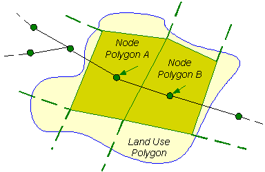

A Node Polygon is used to represent the geographical area in the network that contributes to demand at an associated node.
Node Polygons are used to calculate the proportion of demand from a Land Use area to be assigned to a node. To avoid duplication of demand, node polygons should not overlap. The associated node does not necessarily have to be physically located within the polygon. A single node may have any number of associated node polygons.

Node Polygons and Land Use Polygons
A Node Polygon describes an area that contributes to demand at a node. It does not contain any demand information itself, but can be used to calculate the proportion of demand from a Land Use area to be applied to an associated node.
The Land Use Polygon represents a demand area, for example, an industrial estate. The Land Use Polygon is a normal type polygon. The Polygon Category can be used to identify the polygon as a Land Use Polygon at the time of allocation of the Land Use demand to the network.
The Node Polygons represent the geographical area that contributes to the demand at the associated node.
