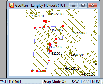

The current snap mode state is displayed in the status bar at the bottom of the main window, but only when snap mode is relevant (that is, whenever a tool is selected that allows creation or editing of a polygon or polyline). It is also shown by the state of the toolbar button - depressed means snap mode is on.

Snap mode switched on
