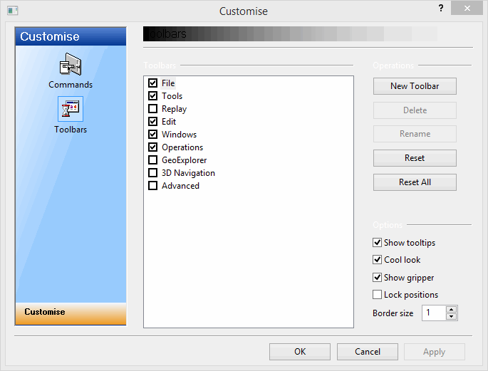

The Toolbars page of the Customise dialog lists the toolbars that are available and indicates those that are currently visible.
Display or hide toolbars by clicking the check boxes to the left of the toolbar names.
The contents of a toolbar can be changed using the Commands page of this dialog.
The operations buttons are used as follows:
New Toolbar |
Creates a new user-defined toolbar. |
Delete |
Enabled for user-defined toolbars only. Deletes the currently selected toolbar. |
Rename |
Enabled for user-defined toolbars only. Allows the name of the toolbar to be changed. |
Reset |
Enabled for InfoWorks WS Pro toolbars only. Resets the currently selected toolbar to display the contents of the toolbar before the current instance of editing (i.e. before the Customise dialog was opened). |
Reset All |
Resets all of the InfoWorks WS Pro toolbars to display the contents of the toolbars before the current instance of editing (i.e. before the Customise dialog was opened. Tip:
To restore the contents of all InfoWorks WS Pro toolbars to their default settings, select the Reset toolbar buttons option from the Tools menu. |
The options check boxes change the way in which the toolbars are displayed:
Show tooltips |
Determines whether descriptions are displayed below the buttons when the mouse pointer rests on them. |
Cool look |
Changes the appearance of the buttons. |
Show gripper |
Displays the gripper bar on the left hand side of the toolbar. |
| Lock positions |
Locks the selected toolbars to their current positions in the window. Note: This does not prevent the positions of the toolbars from being automatically changed if the main window is resized significantly or if
InfoWorks WS Pro is opened on a screen with a very different resolution. If this occurs, uncheck this option, re-position the toolbars and then check this option again. Alternatively, select the Reset toolbars and windows option from the Tools menu.
Border size |
Enter an integer to adjust the size of the toolbar border. Button sizes will not be affected. |
