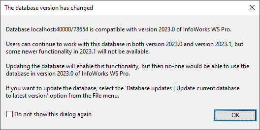

Database Version Change dialog
The Database Version Change dialog is displayed when you install a new version of InfoWorks WS Pro. It informs you that the version for the current database has changed and the implications of updating it to the latest version.
It contains a Do not show this dialog again check box. If unchecked (default), this dialog is displayed every time you open this database.
If checked, the dialog will not be displayed again.
All updates to SQL Server or Oracle databases must be carried out manually using SQL scripts. You will see a different dialog in this case.
