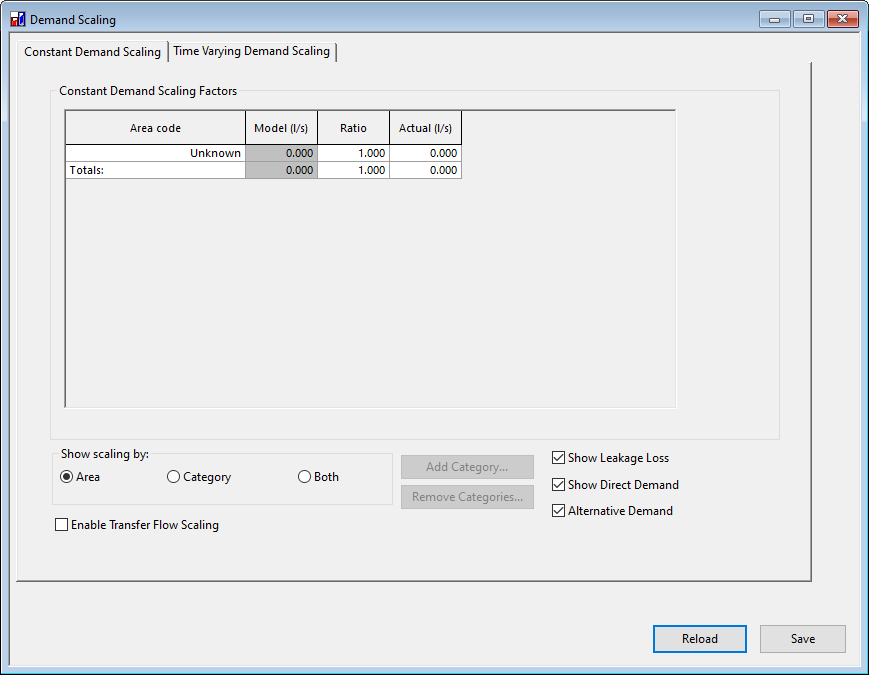

Demand Scaling dialog
The Demand Scaling Editor is used for adjusting groups of demand and transfer flows by applying multiplying factors to existing model demands assigned to nodes.
There are two types of scaling factor that may be defined in the demand editor:
To open a Demand Scaling for editing, either drag the Demand Scaling from the Model Group window or Explorer window onto the main window background, or right click and choose Open from the context menu. You cannot open a Demand Scaling unless there is a current network from which the Demand Scaling can update its values.
If there is Alternative Demand associated with the current network when the Demand Scaling is opened, the Alternative Demand values will be displayed by default in the Demand Scaling.
For full details on how to use the editor, see Editing Demand Scaling.
