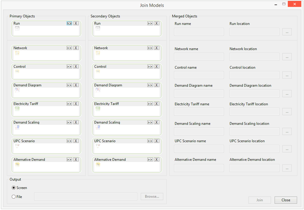

The Join Models dialog is used to combine pairs of model objects into a single merged object.
The dialog is displayed by selecting Join Models from the Tools menu.
Drag and drop objects to be merged into the Primary Objects and Secondary Objects selection boxes, or use the Browse button to browse for objects:
The Merged Object name is the name that will be given to the newly created object:
The Merged Object location is the location in which the newly created object will be saved:
Select the destination for the log report from the Output section:
Click the Join button to merge the selected Primary and Secondary objects. Merged objects will be created with the names, and at the locations, defined in the Merged Objects section of the dialog.
