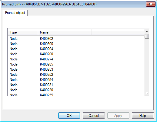

Pruned Objects Properties dialog
The dialog displays the names of the nodes and links that were skeletonised in the same skeletonisation run as the link that has been clicked on.
This dialog is displayed when you click a skeletonised object on the GeoPlan Window with the tool.
For more information, see Skeletoniser.
