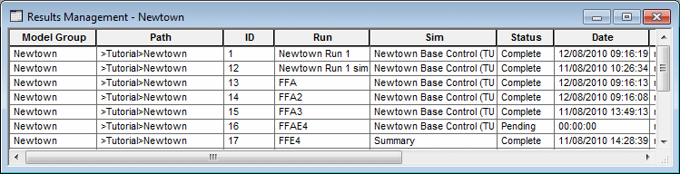

This view allows management of results data stored in the database.
The view displays a grid view of simulations in the database or in a particular run group or model group. The grid describes the simulations, and what results are currently stored. The grid can be used to re-run selected simulations, move results, remove unwanted results, or view further information. For more details on using the view, see Managing results.

| Grid columns |
The Results Management grid contains the following columns: Model Group: The name of the Model Group within which the simulations were carried out. Path: Path of the Model Group within which the simulations were carried out ID: The internal database identifier for this simulation. Run: The name of the run within which the simulations were carried out. Sim: The name of the simulation. Status: The current simulation status: Pending, Complete or Failed. Date: The date and time when the simulation was carried out. User: The user who carried out the simulation. Location: The location where results are stored:
