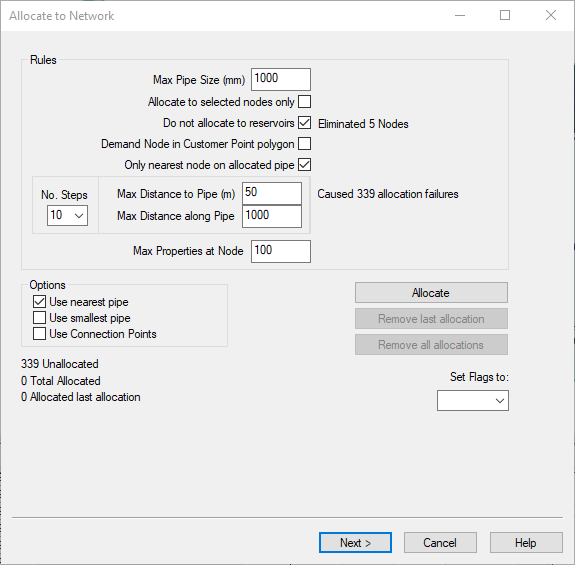

Rules
The table below describes the demand allocation rules when carrying out allocation using Customer Point coordinates.
If the Use connection point option is selected (see Options section below), demand allocation will be carried out using the coordinates of the connection points of customer points where available.
The rules do not apply to child customer points, (with the exception of the Max Properties at Node rule). If the parent customer point satisfies the rules, the parent and children will be allocated, regardless of whether the children satisfy the rules. See Parent and Child Customer Points for more information.
Note that a value of zero for the Max Pipe Size, Max Distance or Max Properties rules, is taken to mean that the rule should not be used in the allocation process.

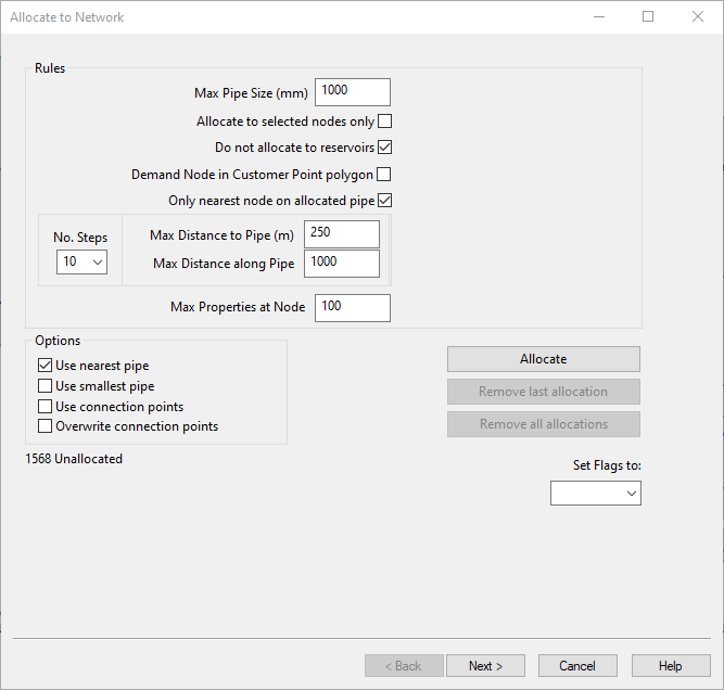

Options
Option Description
Use nearest pipe
Check this option for demand to be allocated to the nearest pipe to the customer point that satisfies the above rules.
If neither the nearest pipe option or the smallest pipe option is selected, InfoWorks will allocate demand to any pipe that satisfies the above rules.
(If the Use connection points option is checked, demand will be allocated to the nearest pipe to the connection point of the customer point.)
Use smallest pipe
Check this option for demand to be allocated to the pipe with the smallest diameter that satisfies the above rules.
Check this option to carry out allocation using connection point coordinates (defined in the Connection Point X and Connection Point Y data fields of the customer point) in preference to customer point coordinates.
  • If connection point coordinates have not been defined for a customer point, the customer point coordinates will be used when carrying out allocation.
  • If the connection point coordinate data fields are flagged as default (#D), the connection point coordinates will be calculated as the nearest location (to the customer point) on the pipe to which the customer point is allocated.
Overwrite connection points
Check this option to overwrite customers points that have been assigned manually to a different connection point. When selected, the affected customer points will use the default (#D) connection point.
When this option is selected, the Use connection points box becomes unavailable.

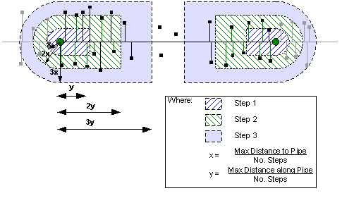

Distance Steps
In order to carry out an accurate demand allocation, an iterative process should be used, increasing the maximum distance along a pipe and the maximum distance to the pipe after each allocation.
The example below shows a demand allocation carried out in five distance steps, increasing the distance along the pipe and distance to the pipe by 100 each step.

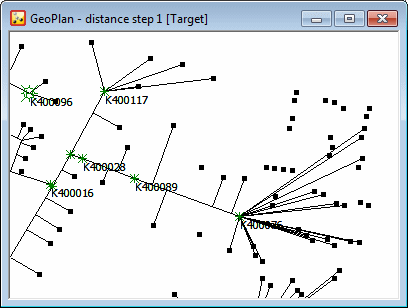

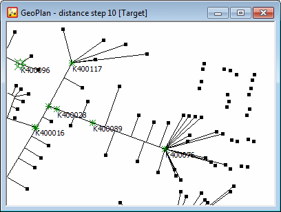

For example, if the customer points that could potentially be allocated to a node exceed the Maximum Properties at Node specified by the user in the Demand Allocation Wizard, allocation of these customer points to the node is effectively random. Customer points further from the pipe may be allocated, while customer points closer to the pipe may not. This is demonstrated in the example below, where demand allocation has been carried out on the same network, using the same allocation parameters, but with a different number of distance steps.
Demand Allocation carried out using one distance step
Demand Allocation carried out using ten distance steps
The distance steps drop down list on the Allocate Page of the Demand Allocation Wizard, provides an "automatic" option for carrying out demand allocation by distance steps.
InfoWorks WS Pro will carry out demand allocation using the number of steps selected from the dropdown list. The options are: 1,2,3,4,5 and 10.
The Max Distance to Pipe and Max Distance along Pipe rules, specified by the user, represent the limits to be used at the last distance step. These limits are divided by the number of distance steps to calculate the amount to increment the Max Distance to Pipe and Max Distance along Pipe parameters at each allocation step.
