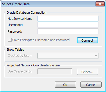

- Use the File browse button to connect to an existing database. The
Select Oracle Data dialog will be displayed.
- In the
Select Oracle Data dialog, connect to an existing database, select the user tables to view and click OK.

- In the Open Data Export Centre dialog, use the File browse button to connect to an existing database. The
Show image
- In the

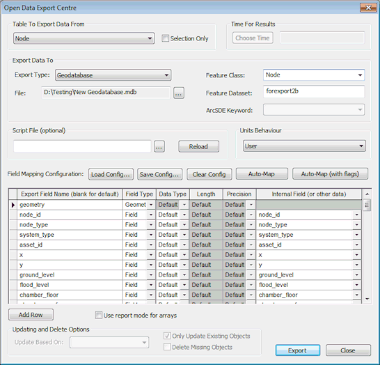

Exporting Spatial Data
When connected to an Oracle server with Oracle Spatial loaded, the geometry of
InfoWorks WS Pro objects can be exported by including an export field of field type Geometry in the
Field Mapping Grid of the Open Data Export Centre dialog.
