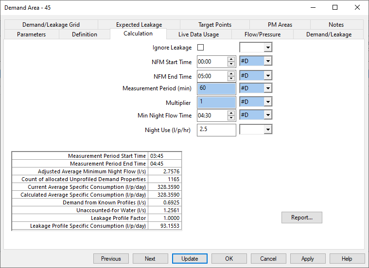

Demand Area Calculation Page
The Demand Area Calculation Page is used to specify Minimum Night Flow parameters and to view a summary of the Demand Analysis.
For further information on the fields on this page, see Demand Area Data Fields.
For more information on Demand Areas, see Demand Area Analysis.
Click the Ignore Leakage button and the Unaccounted-for Water and Leakage Profile Factor will be set to 0.0. Also, all other fields on this tab will be disabled if the leakage is ignored.
Click the Report button to display a report containing summary tables of Demand Area Statistics, Demand Category information and graphs of Demand Profile and Flow Balance. The report can either be copied to clipboard for pasting in another application, or saved as an html file.
Note: For the report to show all valid results the demand diagrams and networks must be updated. See Using the Demand Area Grid for more details.
