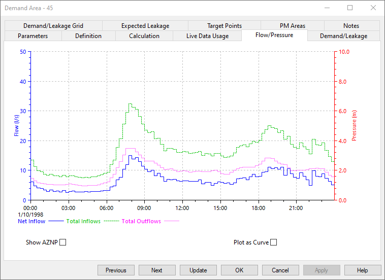

Demand Area Flow/Pressure page
This page is used to view the outputs of the Demand Area live data analysis as a graph. The graph is only populated when the relevant live data configuration file is open, along with the network and control.
The graph shows the following:
If a Demand Area or Pressure Managed Area AZNP node has been defined, pressures at these nodes can be displayed from simulation results and live data. Use the show AZNP drop down to switch between Demand Area and Pressure Managed Area AZNP nodes.
If Target Points have been generated on the Target Points Page , pressures at the Target Point nodes can be displayed from simulation results.
Graph Options
Graph properties can be edited and the graph can be printed or copied to the clipboard by right clicking the graph and selecting an option from the context menu:
