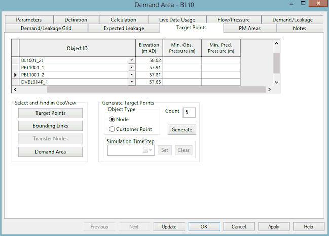

The Demand Area Target Points Page is used to view and edit a list of Target Points. The Target Points list can be used to define nodes or customer points for level of service monitoring. These points can be selected manually, or they can be generated automatically based on either snap shot pressure results or elevations.

Generate Target Points
To generate a list of target points automatically:
Without simulation results the list will be generated by searching for the node or customer point with the highest elevation.
If there are simulation results open on the GeoPlan, the list will be generated by searching for the node / customer point with the lowest pressure at the timestep selected by the user.
Manual Target Point Creation
To define a list of target points automatically:
