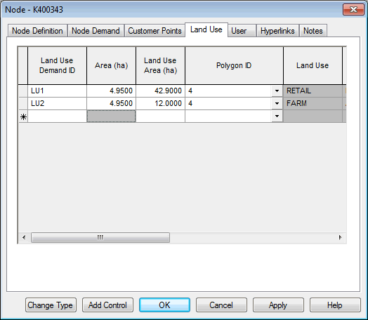

Land Use page
Land Use Demand allocated to a node by the Land Use allocation tool can be viewed on the Land Use Page of the node property sheet.
This page can also be used to manually allocate Land Use demand to the node. See the Allocating Land Use Demand to Nodes topic for more information.
The types of node to which Land Use Demand can be assigned are: Node, Reservoir and Hydrant.
For more information on the data fields on this page see the Basic Node Data Fields and Land Use Data Fields topics.
