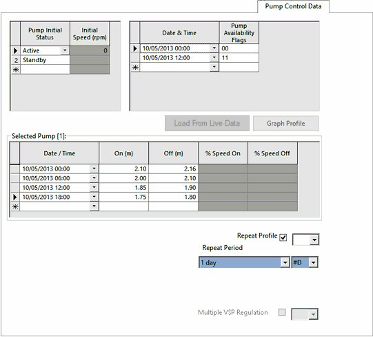

Individual pumps are controlled either by variations of water level in a control reservoir (Level Controlled Pumps), or by variations of pressure in a control node (Pressure Controlled Pumps). The control node/reservoir is specified by the user on the Pump Control Page of the Pump Station Property Sheet.
Standby pumps can also be controlled by the speed of a primary pump.
Control information is entered in the Pump Control Data Page of the property sheet.
Pump Control Data page for Auto mode
The initial status and the initial speed (for variable speed pumps) can be specified for each pump in the pumping station in the top left hand grid. The order of the pump control data corresponds with the order of the pumps specified on the Pump Data Page of the Pump Station Property Sheet.
A time varying profile of control levels and pump speeds may be specified for each pump in the bottom grid. Click the left hand side of the row in the top left hand grid to display profile details for the selected pump.
The Multiple VSP Regulation option is enabled when there is more than one variable speed pump in the pump station. Check this option to allow the pump station to regulate using all identical and available variable speed pumps; pump speeds will vary together to achieve the target. (If variable speed pumps are not identical, the pump station will regulate using the first variable speed pump and pumps identical to that pump to regulate. Other pumps in the pump station will be run at full speed.)
If the Multiple VSP Regulation is unchecked, the pump station will regulate using only the first available variable speed pump. Other pumps in the pump station will be run at full speed.

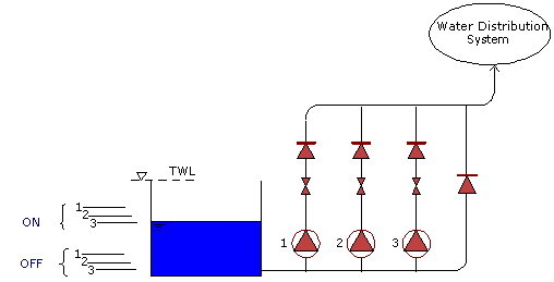

AUTO control - "normal"

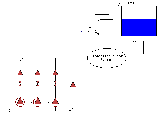

AUTO control - reverse logic
The a) case shows the most common case: as water level rises in the control reservoir, pumps are stopped one after the other (first unit No. 3), preventing overspill. When the level falls, pumps are started in reverse order. Settings "on" and "off" are constant throughout a simulation run. In practice, these settings are periodically adjusted, depending on the season and other circumstances. The user can easily make several runs, with different settings, in order to find the most suitable solution.
The basic idea of this system is "keep the reservoir full", a normal requirement. However, there are cases (admittedly rare in water supply, but common in drainage systems) where the policy is "keep the reservoir empty" - or half-empty, see figure b). Here pumps are started when the water level in the control reservoir rises to a given elevation, and stopped when it falls to a lower level. In InfoWorks this policy is known as "reverse logic" - because it is opposite to the normal one. Again, control levels for each unit are carefully selected, taking into account all facts.

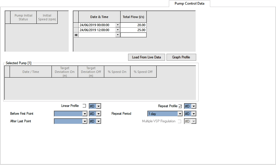

The user specifies the target discharge profile from the pumping station during the simulation period.
Pump Control Data page for Flow mode
This mode may be useful in the calibration process, when the user has to duplicate past events in the model.

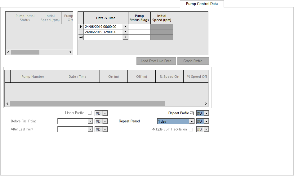

This mode of operation is used for modelling Time Controlled Pumps. Individual pumps are controlled by setting start/stop times for each pump, in the pumping station.
The time clock in InfoWorks WS provides the necessary action during the simulation. If the scheduled time is in the middle of timestep (dt), for example, the action will be slightly postponed to the next steady-state computation.
Pump Control Data page for Plan mode
On/off status is specified by Pump Status Flags where 1 = ON and 0 = OFF. If there is more than one pump in the pumping station, the pump status is entered for each pump in the order that the pumps are specified in the Pump Data Page of the Pump Station Property Sheet.

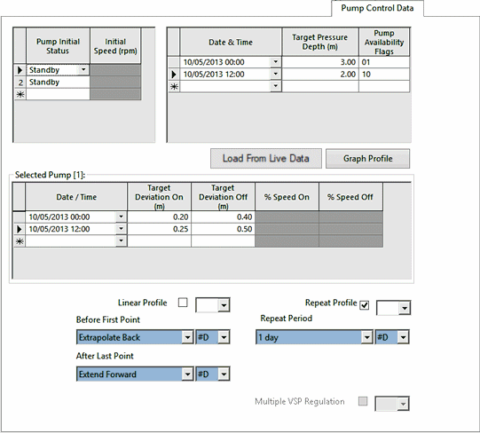

PROFILE (PROF) mode of operation
The PROFILE mode of operation is a more complex form of the AUTO mode used for pressure/level controlled pumps.
In PROFILE mode the user specifies a target pressure/level profile to be met at a Control node, (which may be a node or reservoir), specified in the Pump Control Page of the Pump Station Property Sheet.
The initial status and the initial speed (only required for variable speed pumps) can be specified for each pump in the pumping station in the top left hand grid. (If a variable speed value is not specified, the pump will operate at its nominal speed). The order of the pump control data corresponds with the order of the pumps specified on the Pump Data Page of the Pump Station Property Sheet.
A time varying profile of target deviation on/off values and pump speeds may be specified for each pump in the bottom grid. Click the left hand side of the row in the top left hand grid to display profile details for the selected pump.
Controlling Standby Pumps using Duty Pump Speed
In addition to controlling the status of pumps to a target pressure at a reservoir or node, the speed of a primary pump can be used to control the status of standby pumps.
The % Speed On and % Speed Off fields are used to activate a pump by reference to the current speed of a running pump. The reference pump is taken as the first active variable speed pump in the Pump Station.
If the reference pump's speed exceeds % Speed On, the subject pump will turn on. If the reference pump's speed falls below % Speed Off, the subject pump will turn off. The % Speed values are expressed as a percentage of the reference pump's maximum speed.
For fixed speed pumps, % Speed settings will override Target Deviation On / Off settings unless there are no active variable speed pumps, in which case Target Deviation On / Off settings will be used if defined.
For variable speed pumps, Target Deviation On / Off values must be specified, however % Speed values may be specified as well. If defined both pairs of settings will be used.
Note that reverse logics is not allowed for pumps controlled by speed; % Speed On must be greater than % Speed Off.
Target pressure depth and pump availability profile
A time varying profile of target pressure/depth and availability status can be specified in the top right hand grid.
The target pressure/depth is the target to be met at the Control node specified in the Pump Data Page of the Pump Station Property Sheet.
Availability status is defined using Pump Availability Flags, where 1 = Available and 0 = Unavailable. If there is more than one pump in the pumping station, the pump availability is entered for each pump in the order that the pumps are specified in the Pump Data Page of the Pump Station Property Sheet.
Note:
  • If no availability flags are specified, the pump is assumed to be available.
  • If Pump Initial Status is set to Not Available, the pump is always unavailable regardless of availability flag settings.
PROFILE mode is used to maintain pressure in a distribution area at a target point. It may also be used to maintain a constant level in a reservoir.

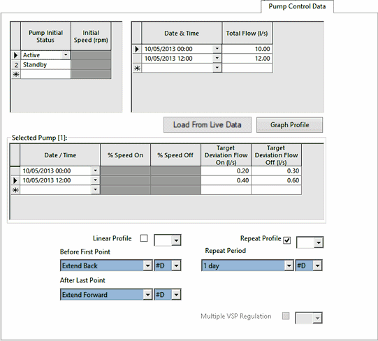

The TARGET FLOW (TFLW) mode of operation is used to model flow controlled pumps working to maintain a target flow profile.
In TFLW mode the user specifies a target flow profile to be met at a Control pipe specified in the Pump Control Page of the Pump Station Property Sheet.
The initial speed (only required for variable speed pumps) can be specified for each pump in the pumping station in the top left hand grid. (If a variable speed value is not specified, the pump will operate at its nominal speed). The order of the pump control data corresponds with the order of the pumps specified on the Pump Data Page of the Pump Station Property Sheet.
In TFLW mode the user may also specify an Override node, (which may be a node or reservoir), and Pressure On and Pressure Off values in the Pump Control Page of the Pump Station Property Sheet. If the pressure/level at the Override node exceeds the Pressure Off value at any time, the pumping station will be stopped immediately, regardless of time controls. The station will resume operation only when the pressure/level at the Override node falls below the Pressure On value.
