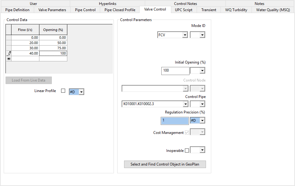

Flow Controlled Valve (FCV)
The flow controlled valve (FCV) reacts according to changes of flow in a control pipe specified by the user.
Flow controlled valves are sophisticated devices and are comparatively rare in practice; yet offer considerable scope for the fine control of distribution systems. When there is an exceptional demand, for example from fire fighting, the valve could open up fully. If the demand increases further, perhaps due to a burst , it will shut down automatically.
The user specifies the relationship between percentage opening of the valve and flow through the valve. The user also specifies the initial opening of the valve at the start of the simulation. If an initial opening is not entered, InfoWorks WS will assume that the valve is closed throughout the simulation.
By default no interpolation is used between data points. Each value entered in the grid is maintained until the next date / time entry, or until the end of the simulation. Check the Linear Profile box for linear interpolation to be used between data points.

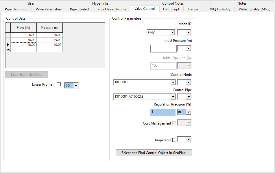

Flow Modulated Valve (FMV)
The flow modulated valve (FMV) is used to control the pressure in a control node specified by the user.
The valve uses the measured flow through the valve to control the pressure at the control node, which is normally close to the valve. This valve will often be used to set the pressure at a remote node when the relationship between the pressures at the two nodes is understood from measurements.
This saves the expense of telemetry feedback from the remote node being used to control the valve.
Show image
The user specifies the relationship between the pressure to be maintained at the control node and flow through the valve.
By default, no interpolation is used between data points. Each value entered in the grid is maintained until the next date / time entry, or until the end of the simulation. You can check the Linear Profile box for linear interpolation to be used between data points.

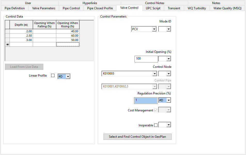

Pressure Controlled Valve (PCV)
The valve operates according to pressure/depth monitored in a control node/reservoir.
This valve can be used to simulate float valve control where measurements have shown the valve to be sticking. Separate opening profiles can be defined for rising and falling levels.
The user specifies the relationship between the control pressure/depth and valve opening.
InfoWorks WS Pro can also simulate quite sophisticated devices like two-way valve, where there are two control curves: one when water level/pressure is increasing, and a different one when water level/pressure is falling.
In simpler cases, the functioning of the valve does not depend on whether level/pressure is rising or falling. To model these cases data should only be entered in the Opening When Rising column, leaving the Opening When Falling column blank.

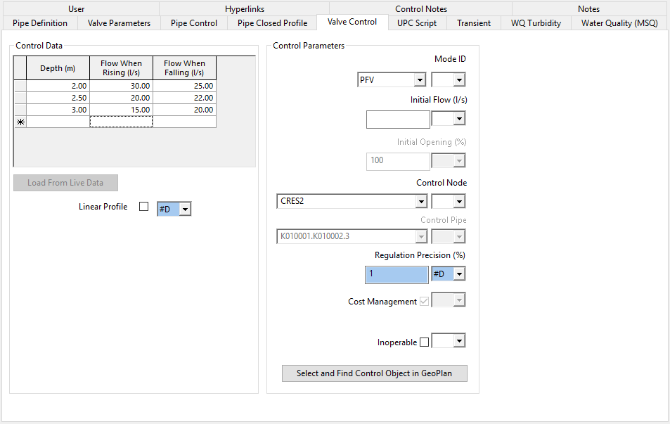

Pressure/Flow Valve
This valve could be used to regulate the flow into a reservoir depending on the level in the reservoir and whether it is rising or falling.
The user specifies the relationship between the control pressure/depth and flow through the valve.
Two control curves should be specified: one when water level/pressure is rising, and a different one when water level/pressure is falling.

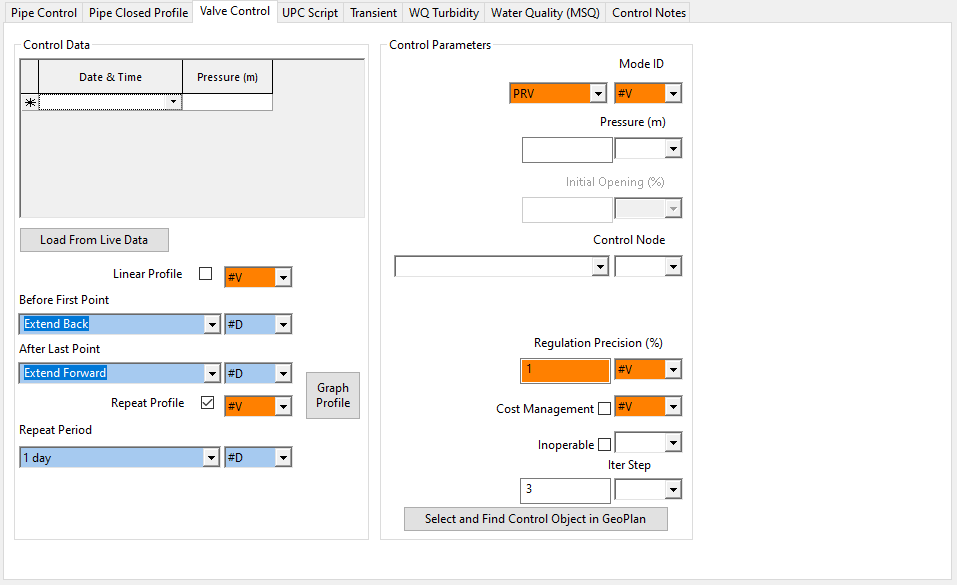

Pressure Reducing Valve (PRV)
The Pressure Reducing Valve (PRV) reduces pressure in a downstream control node to a preset pressure. This target pressure may be constant or time-varying. It is also possible to specify a constant ratio pressure setting between upstream and downstream pressure.
As upstream pressure increases, the valve will close, creating more headloss until the target pressure is achieved. As upstream pressure decreases the valve will open. If the upstream pressure falls below the target pressure, the valve will open fully.
When iteration step (Iter Step) is enabled (value of 1, 2, 3, or any positive integer), this may help stabilize networks with multiple PRVs by delaying control valve setting changes between iterations.
Pressure reducing valves are often used as a means of reducing leakage in areas that would experience high pressures if not controlled.
The user specifies a downstream pressure and/or a time varying pressure profile to be maintained.
Note: If both a constant target pressure and a series of variable target pressures have been entered, the variable target pressures are used.
If a value between 0 and 1 is entered as the constant target pressure, the valve will be simulated as a constant ratio PRV where:
Downstream Pressure in control node = Pressure value specified * Upstream Pressure
or
Pressure Value specified = Downstream Pressure / Upstream Pressure
When using a time varying pressure profile; by default no interpolation is used between data points. Each value entered in the grid is maintained until the next date / time entry, or until the end of the simulation. You can check the Linear Profile box for linear interpolation to be used between data points.
For details of options available for extending the profile outside of the entered dates / times see Profile extension options.

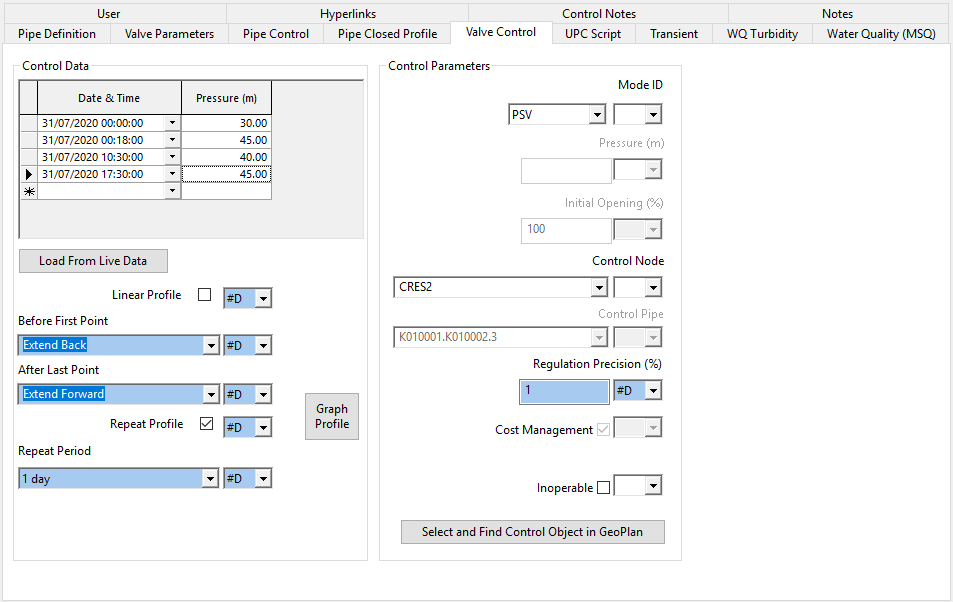

Pressure Sustaining Valve
The Pressure Sustaining Valve (PSV) maintains a minimum preset pressure in an upstream control node. This pressure may be constant or time-varying.
As upstream pressure decreases, the valve will close. As upstream pressure increases, the valve will open.
Pressure sustaining valves may be used, for example, in distribution systems with cascading pressure zones, where a downstream zone demand may cause low pressure problems in an upstream zone if not controlled.
Valve Control - PSV
The user specifies a minimum upstream pressure or a time varying pressure profile to be maintained.
When using a time varying pressure profile, by default no interpolation is used between data points. Each value entered in the grid is maintained until the next date / time entry, or until the end of the simulation. You can check the Linear Profile box for linear interpolation to be used between data points.

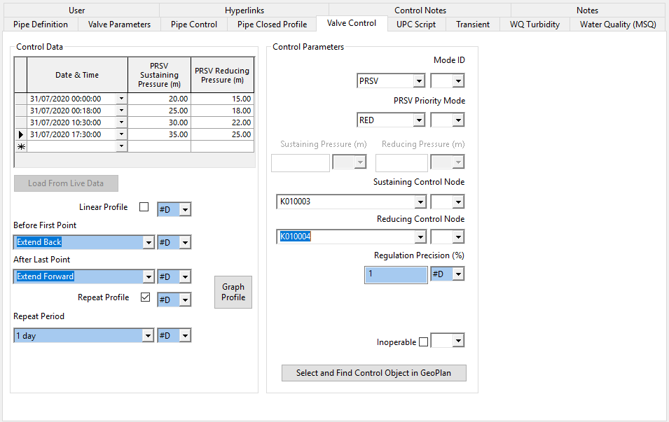

Pressure Reducing / Sustaining Valve
The Pressure Reducing / Sustaining Valve (PRSV) combines the functions of the PRV and PSV.
The valve will attempt to reduce downstream pressure at a reducing control node and sustain upstream pressure at a sustaining control node to specified target pressures.
The PRSV priority mode is used to set which pressure target takes priority:
  • In mode SUS the priority is to sustain the upstream pressure target. As long as the upstream target pressure is equalled or exceeded, the valve will also attempt to maintain the downstream pressure.
  • In mode RED the priority is to maintain the downstream pressure target. As long as the pressure downstream equals or is below the downstream target pressure, the valve will also attempt to sustain upstream pressure.
The user specifies a minimum upstream pressure and maximum downstream pressure or a time varying pressure profile to be maintained.
Note: If both constant target pressures and a series of variable target pressures have been entered, the variable target pressures are used.

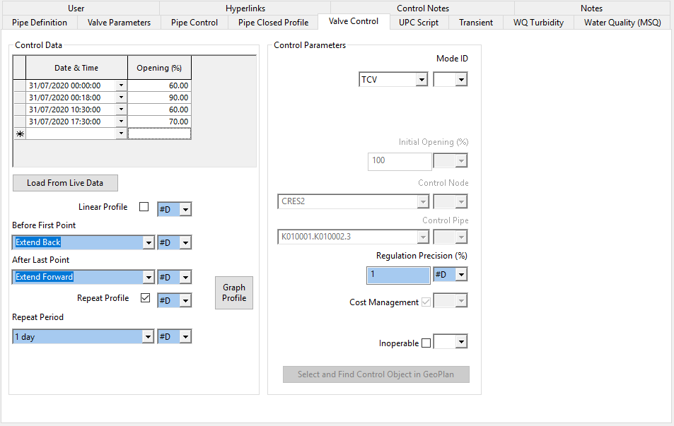

Time Controlled Valve
The time controlled valve operates to a time schedule specified by the user.
Time controlled valves may be used for example for scheduled transfer of water from one area to another.
This option is also particularly useful for calibration of models.
Valve Control - TCV
The user specifies a time varying profile for valve operation over the simulation time.
By default no interpolation is used between data points. Each value entered in the grid is maintained until the next date / time entry, or until the end of the simulation. You can check the Linear Profile box for linear interpolation to be used between data points.

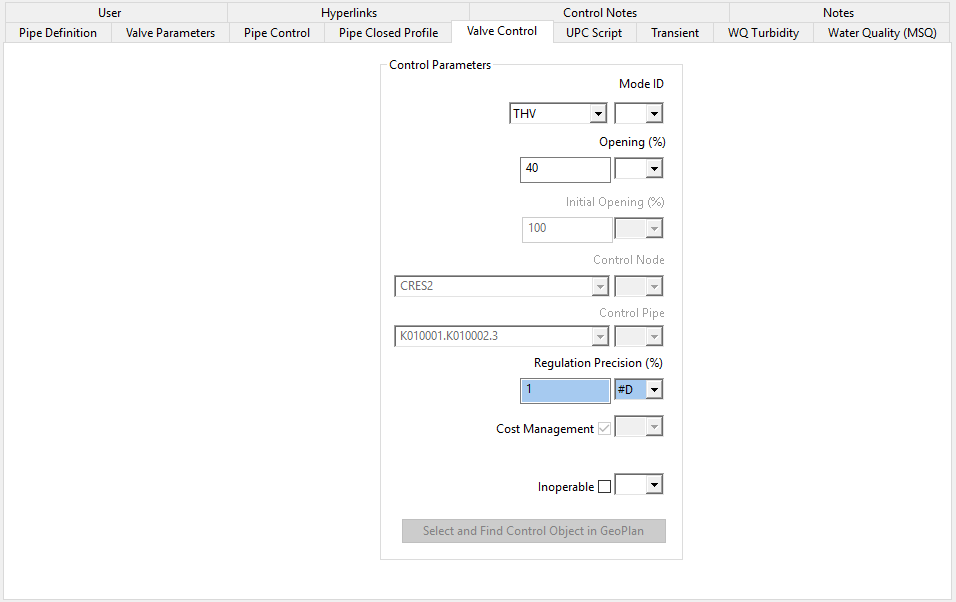

Throttled Valve (THV)
The throttled valve acts as a local obstruction to flow. The opening of the valve remains constant during the simulation.
Throttle valves may be used for example to restrict flow through pumps.
This option may also be used in calibration of models, where a local obstruction in a pipe is suspected.
The user specifies the percentage opening of the valve, which is maintained throughout the simulation.
