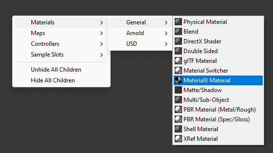

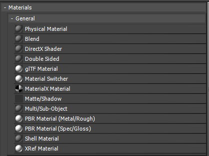

A. You can find this material in the Material Browser as MaterialX Material.
B. You can also find it in the Materials > General list when right-clicking in a Slate view.

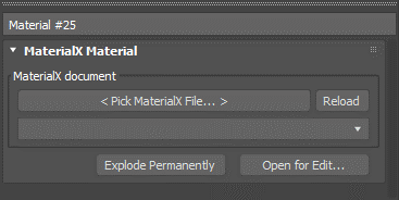

Once loaded, you can click Pick MaterialX file in the Material Editor and browse for a .mtlx file on your computer.
Tip:
There are several libraries of high-quality materials freely available on the internet, including the open source MaterialX Library from AMD.
The drop-down list in the MaterialX Material section will allow you to switch between different materials within the same MaterialX definition as a MaterialX file can contain multiple materials. However, most files will only list a single material.
Use the following features in the MaterialX Material section to work with your chosen material(s).
- Reload: This button will re-import the current MaterialX file and update the material from the file. This is useful if the file was updated and you need to see the results. This function is run automatically when a scene is loaded.
- Explode Permanently: When this button is pressed, the MaterialX Material is converted to a Physical Material with MaterialX-compliant OSL nodes and display that material in Slate. This will allow you to edit that material within Slate. When pressed, the MaterialX Material is replaced in the scene with the new Physical Material.
- Warning: The current MaterialX Material remains in the material editor until you select a material.
- Open For Edit: Open for Edit will display the current MaterialX Material as a Physical Material with OSL nodes. Changes to this material will reflect in the viewport but will not persist in the scene after the scene closes or you refresh the MaterialX Material. This feature is experimental and for debugging. The function may be removed from future updates.

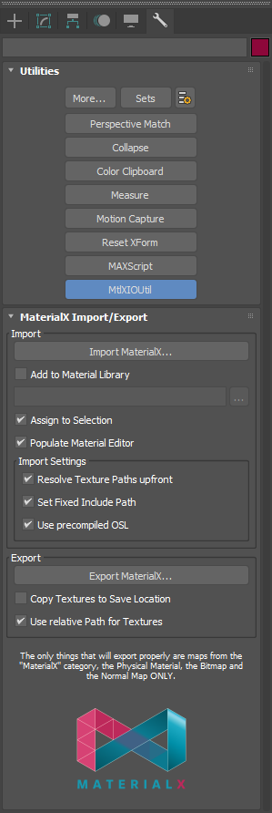

The MaterialX Utilities are tools for importing and exporting MaterialX files. You can find in the Command Panel > Utilities Tab > More… > select MtlxIOUtil.
Importing MaterialX
- Open the
MtlxIOUtil in the Utilities tab of the command panel.
- Use your desired settings in the Import section.
- Click the Import MaterialX button to browse for a
.mtlx file.
Exporting MaterialX
Important: You can author MaterialX files by using these rules:
- Use only Physical Materials
- Use only the OSL maps found under MaterialX or the BitmapTexture
- Apply the material or materials you want to objects in the scene.
- Open the
- Select the objects in the scene that have the materials you want to export.
- Click the Export MaterialX… button.
- Choose a filename.
- Choose your export settings:
- Copy Textures to Save Location: When enabled, bitmaps will be copied to the same location as the .mtlx file. This is useful when distributing a material.
- Use Relative Paths for Textures: When enabled, the path to the textures in the
.mtlx file will be relative to the .mtlx file. This is useful when creating sharable assets.
