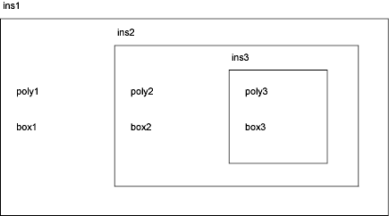

The example that follows shows highlighting nested block references. As shown in the following figure, the example creates six entities: three polys (a custom entity) and three boxes. It also creates three block references (inserts). Insert 3 (ins3) is an insert of a block that contains poly3 and box3. Insert 2 (ins2) is an insert of a block that contains poly2, box2, and ins3. Insert 1 (ins1) is an insert of a block that contains poly1, box1, and ins2.
After the inserts are created, the example highlights the different components.
