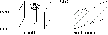

Creates a region that represents the intersection of a plane defined by three points and the solid.
