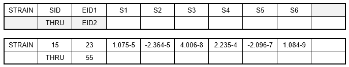

Format:
Example:
Alternate Format and Example:

- Strain vectors are specified either at the element centroid or the corner nodes. When corner data is input, the strain vector repeats the number of corner nodes minus one times. For shell elements, the input format is:
For solid elements, the format is:
