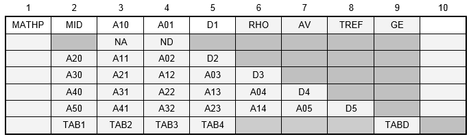

Description: Defines material properties for use in fully nonlinear (i.e., large strain and large rotation) hyperelastic analysis of rubber-like materials (elastomers) for isoparametric solid elements.
Format:
Example:
| Field | Definition | Type | Default |
| MID | Material identification number. | Integer > 0 | Required |
| Aij | Material constants related to distortional deformation. | Real | 0.0 |
| Di | Material constants related to volumetric deformation. | Real ≥ 0 | 10 3 * (A10 + A01) for D1. 0.0 for D2 through D5 |
| RHO | Mass density in original configuration. | Real | 0.0 |
| AV | Volumetric coefficient of thermal expansion. | Real | 0.0 |
| TREF | Reference temperature for the calculation of thermal loads. | Real | 0.0 |
| GE | Structural element damping coefficient. See Remarks 7 and 9. | Real | 0.0 |
| NA | Order of the distortional strain energy polynomial function. | 0 < Integer ≤ 5 | 1 |
| ND | Order of the volumetric strain energy polynomial function. | 0 < Integer ≤ 5 | 1 |
| TAB1 | Table identification number of
TABLES1 entry that contains simple tension/compression data to be used in the estimation of the material constants Aij. xi values in the TABLES1 entry must be stretch ratios
and yi values must be values of the engineering stress
. Stresses are negative for compression and positive for tension. If this convention is not followed the solution may fail to converge.
Integer > 0 or blank | |
| TAB2 | Table identification number of TABLES1 entry that contains equibiaxial tension data to be used in the estimation of the material constants Aij. xi values in the TABLES1 entry must be stretch ratios
. yi values must be values of the engineering stress
is the current length,
is the current force,
is the initial length and
is the cross-sectional area. In the case of pressure of a spherical membrane, the engineering stress is given by
, where
is the current value of the pressure and
is the initial radius and thickness.
| TAB3 | Table identification number of TABLES1 entry that contains simple shear data to be used in the estimation of the material constants Aij. xi values in the TABLES1 entry must be values of the shear tangent
| TAB4 | Table identification number of TABLES1 entry that contains pure shear data to be used in the estimation of the material constants Aij. xi and yi values in the TABLES1 entry must be stretch ratios
and values of the nominal stress
and
are the initial length and cross-sectional area, respectively in the 1-direction.
| TABD | Table identification number of TABLES1 entry that contains pure volumetric compression data to be used in the estimation of the material constants Di. xi values in the TABLES1 entry must be values of the volume ratio
, where
is the stretch ratio in all three directions; yi values must be values of the pressure, assumed positive in compression.
