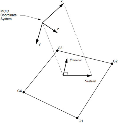

Figure 1. MCID Coordinate System Definition

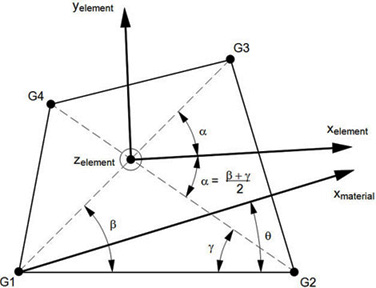

Figure 2. CQUAD4 Element Geometry and Coordinate System
