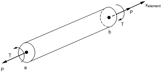

where T is the torsional moment.
Figure 1. CONROD Element Internal Forces and Moments
