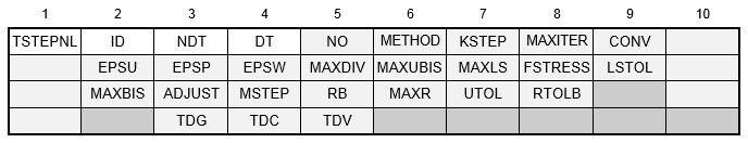

Description: Defines a set of parameters for nonlinear transient analysis.
Format:
Example:
