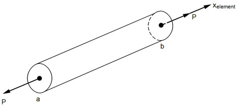

Figure 1. CCABLE Element Internal Forces
