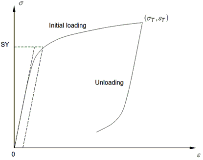

). See Figure 1.
Figure 1. Stress-Strain Curve Definition for MATS2 Material
