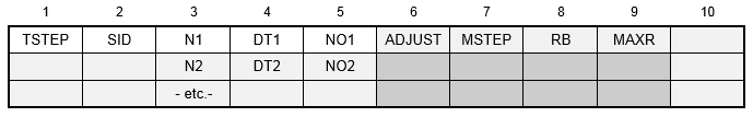

Description: Defines time step intervals at which a solution will be generated and output in transient response analysis.
Format:
Example:
| Field | Definition | Type | Default |
| SID | Set identification number. | Integer > 0 | Required |
| Ni | Number of time steps of values DTi. | Integer ≥ 1 | Required |
| DTi | Time increment. | Real > 0 | Required |
| NOi | Skip factor for output. Every NOi-th step will be output. | Integer > 0 | 1 |
| ADJUST | Time step skip factor for automatic time step adjustment. See Remark 3. | Integer ≥ 0 | 5 |
| MSTEP | Number of steps to obtain the dominant period response. See Remark 4. | 10 ≤ Integer ≤ 200 | Variable between 20 and 40. |
| RB | Bounds for maintaining the same time step for the stepping function. See Remark 4. | 0.1 ≤ Real ≤ 1.0 | 0.75 |
| MAXR | Maximum ratio for the adjusted incremental time relative to DT allowed for time step adjustment. See Remark 5. | 1.0 ≤ Real ≤ 32.0 | 16.0 |
