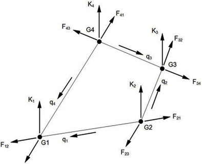

Figure 1. CSHEAR Element Connection and Coordinate System
Figure 2. CSHEAR Element Corner Forces and Shear Flows
