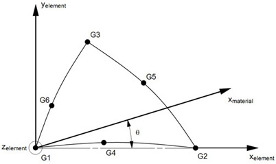

Figure 1. MCID Coordinate System Definition
Figure 2. CTRIA6 Element Geometry and Coordinate System
