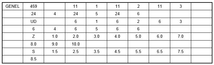

Description: Defines a general element.
Format:
UIm - The last item in the UI list will appear in one of fields 2, 4, 6, or 8.
UDn - The last item in the UD list will appear in one of fields 2, 4, 6, or 8.
KZmm - The last item in the K or Z matrix will appear in one of the fields 2 through 9.
Smn - The last item in the S matrix will appear in one of fields 2 through 9.
Example:
| Field | Definition | Type | Default |
| EID | Element identification number. | Integer > 0 | Required |
| Uli, Cli UDj, CDj | Identification numbers of coordinates in the UI or UD list, in sequence corresponding to the
, and
matrixes. UIi and UDi are grid point numbers, CIi and CDj are the component numbers.
Integer ≥ 0 | |

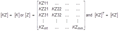

| KZij | Values of the
or
matrix ordered by columns from the diagonal, according to the UI list.
Real | Required |
| Sij | Values of the
matrix ordered by rows according to the UD list.
Real | See Remark 1 |
| UD, K, Z, and S | Character variables that indicate the start of data belonging to the UD list or the
, or
matrixes.
Character |
