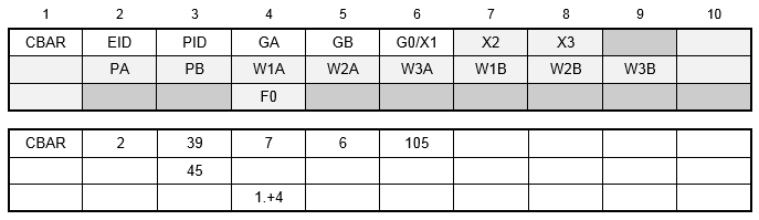

Format:
Example:

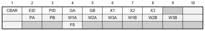

Alternate Format and Example:

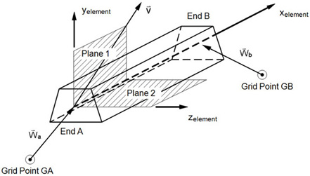

Figure 1. CBAR Element Geometry

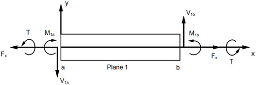

Figure 2. CBAR Element Internal Forces and Moments (xy-Plane)

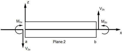

Figure 3. CBAR Element Internal Forces and Moments (xz-Plane)
