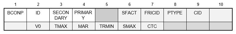

Format:
Example:

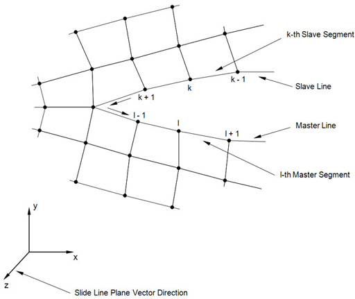

Figure 1. Slide Line Contact Definition
