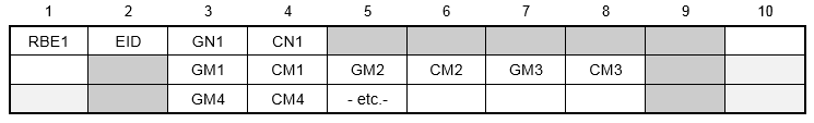

Description: Defines a rigid body connected to an arbitrary number of grid points.
Format:
Example:
| Field | Definition | Type | Default |
| EID | Element identification number. | Integer > 0 | Required |
| GNi | Identification number of grid point to which independent degrees of freedom for the element are assigned. | Integer > 0 | Required |
| CNi | Independent degrees of freedom in the global coordinate system for the rigid element at grid points GNi. See Remark 1. (Up to six unique digits may be placed in the field with no embedded blanks.) | 1 ≤ Integers ≤ 6 | Required |
| GMj | Grid point identification numbers at which dependent degrees of freedom are assigned. | Integer > 0 | |
| CMj | Dependent degrees of freedom in the global coordinate system at grid points GMj. (Up to six unique digits may be placed in the field with no embedded blanks.) | 1 ≤ Integers ≤ 6 |
