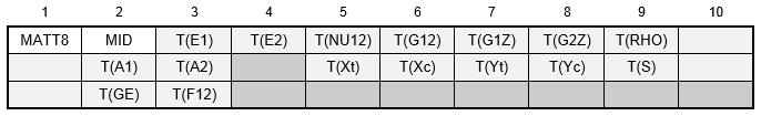

Description: Specifies temperature-dependent table references for MAT8 material properties. This entry is used if a MAT8 entry is specified with the same MID.
Format:
Example:
