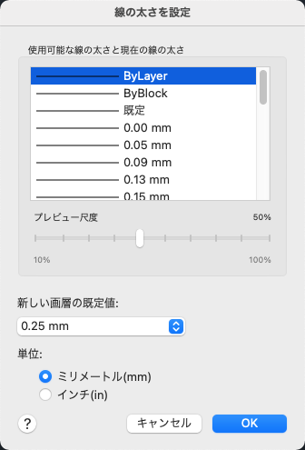

Sets the current lineweight, sets the lineweight units, controls the display and display scale of lineweights, and sets the DEFAULT lineweight value for layers.
LWEIGHT (Command)
Menu: .
The following options are displayed.
Specifies whether lineweights are displayed in millimeters or inches. You can also set Units for Listing by using the LWUNITS system variable.
Specifies lineweight values in millimeters.
Specifies lineweight values in inches.
Controls the DEFAULT lineweight for layers. The initial DEFAULT lineweight is 0.01 inches or 0.25 mm. (LWDEFAULT system variable)
Displays the available lineweight values and shows which lineweight is current. The current lineweight is shown highlighted in the list.
Lineweight values consist of standard settings including BYLAYER, BYBLOCK, and DEFAULT. The DEFAULT value is set by the LWDEFAULT system variable, which has an initial value of 0.01 inches or 0.25 mm. All new layers use the default setting. The lineweight value of 0 plots at the thinnest lineweight available on the specified plotting device and is displayed at one pixel wide in model space.
Controls the display scale of lineweights on the Model layout. On the Model layout, lineweights are displayed in pixels. Lineweights are displayed using a pixel width in proportion to the real-world unit value at which they plot. If you are using a high-resolution monitor, you can adjust the lineweight display scale to better display different lineweight widths. The Lineweight list reflects the current display scale.
Objects with lineweights that are displayed with a width of more than one pixel may increase regeneration time. If you want to optimize performance when working in the Model layout, set the lineweight display scale to the minimum value or turn off lineweight display altogether.
