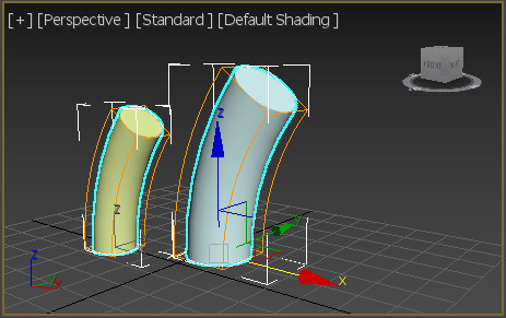

In the screen capture and diagram below, the user has selected two independent Cylinders in the scene, checked the 'Use Pivot Points' box, and applied a Bend modifier.
Note that each cylinder has its own Derived Object. The modifier reference of each ModApp points to the same instanced modifier however. The ModApp also stores the ModContext (labeled 'MC' in the diagrams). One data member of this ModContext is the bounding box of the deformation. Because the 'Use Pivot Points' button was checked at the time the bend was applied, each bounding box stored in the ModContext is the size of each cylinder alone. Additionally, the transformation matrix of each ModContext reflects that the bend is to be applied to each cylinder in its own space. The result is the bend is applied locally and independently to each cylinder.

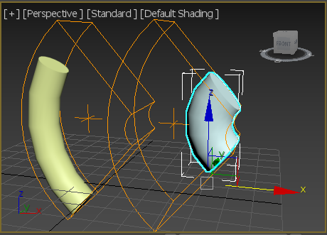

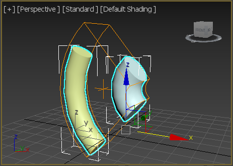

Contrast this with the following case. In the screen capture, below, the user applied the Bend modifier to the cylinders as follows: First the independent cylinders were selected. Then the 'Use Pivot Points' button was unchecked. Then the Bend modifier was applied. This means the bend will be applied to the entire selection set as a whole. Note that the cylinders are bent about a common center.
In this case the bend is applied relative to the bounding box of both cylinders. Thus the bounding box of the ModContexts are the same for each cylinder. Note what happens if one cylinder is moved away from the other in the scene. The Modifer is selected so the gizmo shows the bounding box graphically. The bounding box remains the size of both even when the objects no longer share the same world space relationship.
The separation of the ModApps from the Modifier allows this flexibility. The bounding box stored with the ModContext of the ModApp represents the scale of the application of the modifier. The transformation matrix of the ModContext represents the space the modifier was applied in. The instanced modifier just uses this information to properly modify each input object.

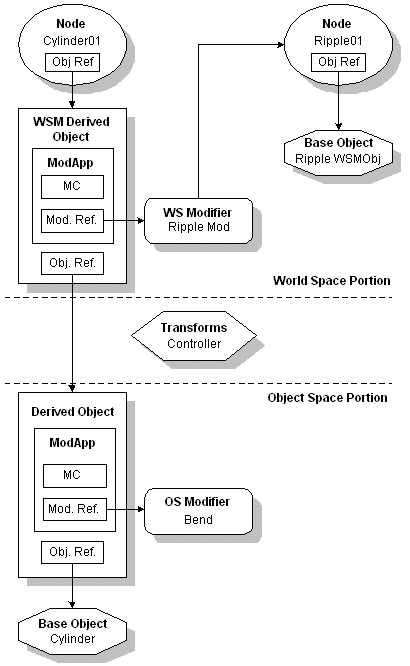

This following presents a detailed look at the flow of the pipeline from the Base Object to the resulting World Space Cache. This includes the derived objects of the object space portion of the pipeline, the application of the node's transform controller, and through the world space portion of the pipeline.
The diagram below shows a procedural Cylinder with a Bend modifier applied, and bound to a Ripple space warp.
The data flow in the pipeline follows the object references. In the example above, the Cylinder01 Node has an object reference pointing to the world space modifier object. Its object reference points to the Derived Object. Its object reference points to the Cylinder Base Object. This is the path the data follows as it moves along the pipeline.
The actual object that flows between these references is an ObjectState. The ObjectState is the result of the Object::Eval() method being called on the object reference.
This pipeline starts at the Base Object -- the Cylinder. The system asks the cylinder to evaluate itself. In the cylinder's implementation of Object::Eval(), it simply returns itself ( returnObjectState(this); ). It returns this ObjectState to the next object reference in the pipeline. This is the object reference of the derived object.
The Derived Object sends this ObjectState through each of its ModApps. In this example, the only ModApp is for the Bend Modifier. The Bend requires Deformable objects (it indicates this in its implementation of Modifier::InputType()). The ModApp handles converting the object to the appropriate type for the Modifier. The cylinder is asked to convert itself to a Deformable object. It does this in its implementation of Object::ConvertToType() by creating a new TriObject and setting the TriObject's mesh pointer to point at the cylinder's triangle mesh.
This Deformable TriObject is then sent through the Bend Modifier. The Bend is passed the ModApp's ModContext as an argument to its Modifier::ModifyObject() method. The Bend first modifies the points of the TriObject using the transformation matrix of the ModContext. This puts the object into the space the modifier was applied in. Next the Bend applies its deformation to the points (it bends them). Then the Bend modifies the points of the TriObject by the inverse of the ModContext transformation matrix. This restores the object, excepting it now has the bend effect applied.
At this point, the Derived Object returns the result to the next Object Reference in the pipeline. In this case the result is a TriObject that has been bent. It is returned to the Object Reference of a World Space Derived Object.
This juncture between the Derived Object and the World Space Modifier Derived Object is where the pipeline crosses from object space to world space. At this point the result of the node's transform controller, and the object offset transformation are put into the pipeline. For more details on these various transformation matrices see the Advanced Topics section on Node Transformations.
