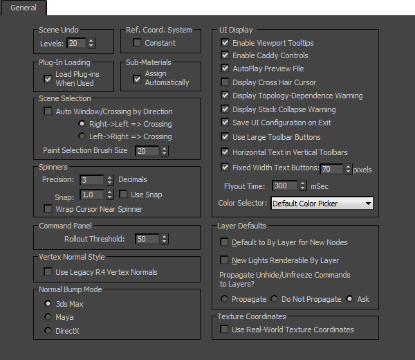

Normal Bump Modes
3ds Max supports the following normal bump modes: 3ds Max Mode, Maya Mode, and DirectX Mode. You can select a normal bump mode in the General tab of the Preferences Settings dialog, which can be accessed by selecting Customize Preferences. The calculation of tangents and bitangents vary based on the normal bump mode.
The following figure shows the three normal bump modes in the Preferences Settings dialog.
These normal bump modes are explained in the following table.
Mode Description
**3ds Max Mode ** The face normal that is always perpendicular to the triangle face is used in the calculation. During pixel shading, the tangent and bitangent interpolated from the triangle vertices are used in the normal bump calculation.
**Maya Mode ** The vertex normal that considers smooth group and which can be tuned using the Edit Normals modifier is used in the calculation. During pixel shading, the tangent and bitangent interpolated from the triangle vertices are orthogonalized against the normal before the normal bump calculation.
**DirectX Mode ** The vertex tangent and bitangent are perpendicular to the vertex normal. During pixel shading, the tangent and bitangent interpolated from the triangle vertices are used in the normal bump calculation.
