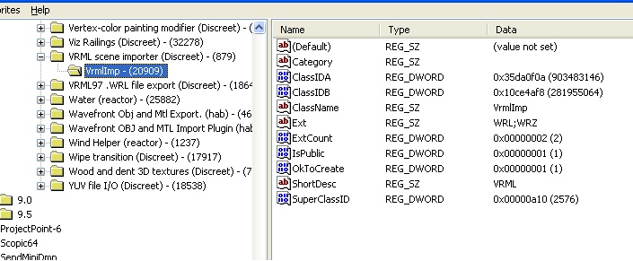

Class Key Values
| Name | Type | Data |
| Category | REG_SZ | |
| ClassIDA | REG_DWORD | 0x35da0f0a (903483146) |
| ClassIDB | REG_DWORD | 0x10ce4af8 (281955064) |
| ClassName | REG_SZ | VrmlImp |
| Ext | REG_SZ | WRL;WRZ |
| ExtCount | REG_DWORD | 0x00000002 (2) |
| IsPublic | REG_DWORD | 0x00000001 (1) |
| OKToCreate | REG_DWORD | 0x00000001 (1) |
| ShortDesc | REG_SZ | VRML |
| SuperClassID | REG_DWORD | 0x00000a10 (2576) |
Notes: The IsPublic and OKToCreate values should be 0 (no) or 1 (yes). The Ext value consists of upper-case file extensions (without the leading dot); if there are more than one, they are separated by semicolons, with no spaces before or after. The number of extensions given in the Ext value must agree with the ExtCount value. The InternalName value should not be defined if it returns NULL.
