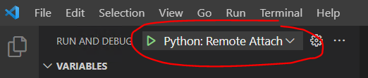

Connecting with VS Code
First open the Run and Debug view by selecting View > Open View... and selecting "Run and Debug".
We need to select our Debug Config in VS Code:
Debug Config
Ensure that our Python: Remote Attach configuration is selected. When this is the case we can connect the debugger to 3ds Max Python by selecting Debug > Start Debugging from the VS Code menu.
If we go back to 3ds Max, we see that the UI is no longer frozen. However, our program is still not running.

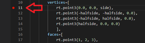

Adding a breakpoint
We know, from a previous run of our program that there is a problem on line 11 of graphics.py. So in VS Code we can add a breakpoint on this line by clicking the margin at the left of the line:
Breakpoint
Note:
Note: if this does not work, it could be that your remoteRoot path mapping is wrong, or that something else in the previous steps did not go well (for example, your debugger is not running).

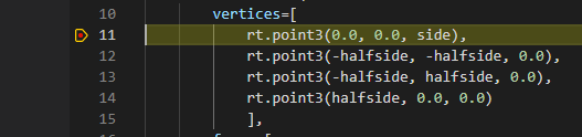

Triggering the breakpoint
At this point when you click on the Pyramid button of your dialog, your breakpoint will be reached and you will see it highlighted in VS Code.
BreakpointReached
You will be able to inspect the locals and you will see that the side variable is False, which is not what we want.

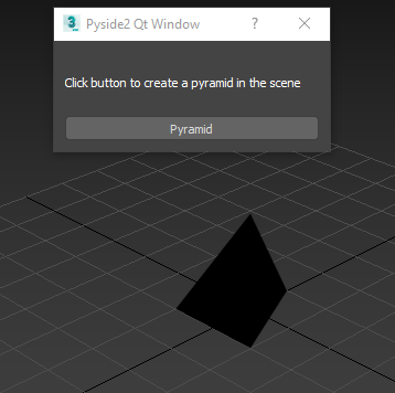

To give the control back to max we press F5 (Run -> Continue). We see that 3ds Max becomes responsive again.
import importlib
and then
importlib.reload(pyramid.ui)
This displays something like:
<module 'pyramid.ui' from 'd:\\sources\\hacking\\python\\pyramid\\pyramid\\ui.py'>
dialog = pyramid.ui.PyMaxDialog()
Our breakpoint is reached, but this time side = 20 and halfside = 10 and if we hit F5 the code will now successfully complete and show our black pyramid in the viewport.
Result
