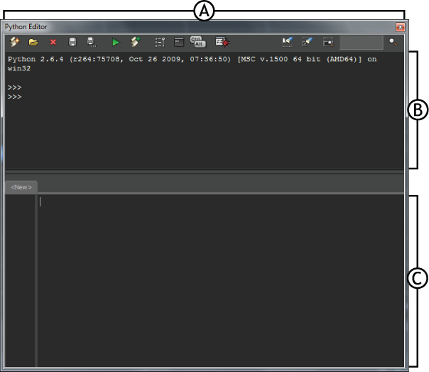

The MotionBuilder Python Editor is accessed under Window > Python Editor. This editor is a convenient place to write and run Python programs for MotionBuilder. The Python Editor (as shown below) is composed of three major sections.
Editor preferences may be modified in MotionBuilder > Settings > Preferences > Python. Syntax highlighting, line numbering, auto indentation, and script reloading are enabled by default. The color scheme and font styles for the work area and the interactive console may also be customized here.
The Python server can also be enabled through the Python Telnet Console, and incoming connections can be allowed. These features are enabled by default. The startup directory can be customized here. For more information, see Running Python Scripts.
