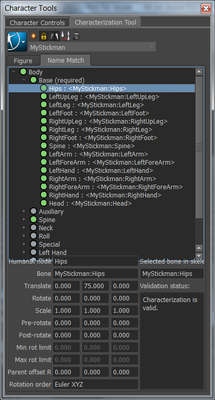

Characterizing a Skeleton
An FBCharacter is said to be "characterized" if a minimal hierarchy of FBModel has been assigned to the "Base" (required) character slots. The following list presents the names of these required character slots: HipsLink, LeftUpLegLink, LeftLegLink, LeftFootLink, RightUpLegLink, RightLegLink, RightFootLink, SpineLink, LeftArmLink, LeftForeArmLink, LeftHandLink, RightArmLink, RightForeArmLink, RightHandLink, HeadLink. The image below shows a valid characterization of the required character slots.
When the required slots have been associated with a joint in a skeleton, the FBCharacter.SetCharacterizeOn() function may be called with the True parameter. When a character is successfully characterized, an inverse and/or forward kinematic control rig may be created using FBCharacter.CreateControlRig(). To display and use this control rig, set the FBCharacter.ActiveInput property to True.
The code below is taken from Example: Creating a Character, and illustrates how to characterize a skeleton.

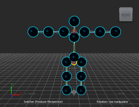

Sample Viewport Output:
Program Summary: The program below first defines a template which will be used to create a hierarchy of FBModelSkeleton joints. The joint names are important here because they correspond to MotionBuilder's most basic biped characterization naming template.
Once the skeleton is created, we apply cartoon-shaded spheres to each joint to make our character more visually appealing. In practice however, we would assign a mesh to the skeleton's 'Reference' model. The vertices of this mesh would be weighted according to the character's bones. This lengthy process is omitted for clarity.
The program concludes by characterizing the skeleton, and creating a forward- and inverse-kinematic control rig.

def characterizeSkeleton(pCharacterName, pSkeleton):
    # Create a new character.
    character = FBCharacter(pCharacterName)
    FBApplication().CurrentCharacter = character
    # Add each joint in our skeleton to the character.
    for jointName, joint in pSkeleton.items():
        slot = character.PropertyList.Find(jointName + 'Link')
        slot.append(joint)
    # Flag that the character has been characterized.
    character.SetCharacterizeOn(True)
    # Create a control rig using Forward and Inverse Kinematics,
    # as specified by the "True" parameter.
    character.CreateControlRig(True)
    # Set the control rig to active.
    character.ActiveInput = True
    return character

# Clear the scene.
FBApplication().FileNew()
# Create a new skeleton.
characterName = 'MyStickman'
skeleton = createSkeleton(characterName)
# Apply a model to each limb of the skeleton.
templateModel = createModel()
applyModelToSkeleton(skeleton, templateModel)
templateModel.FBDelete() # We do not need the template model anymore.
# Characterize the skeleton and create a control rig.
character = characterizeSkeleton(characterName, skeleton)
