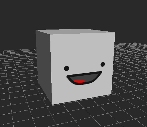

Example: Applying a Texture to a Model
Sample Viewport Output:
Texture File and Location: C:\<user>\Documents\MB\Face.png
Program Summary: The program below creates a cube model, and creates a texture from the 'Face.png' file contained in the current user's My Documents folder. It then associates the texture to a new material's diffuse channel, and appends the material to the model.
from pyfbsdk import *
import os
# Get the texture file residing in the current user's My Documents\MB folder.
myDocuments = os.path.expanduser('~') + r'\Documents\MB'
textureFilename = 'Face.png'
textureFullPath = os.path.join(myDocuments, textureFilename)
# Helper Function(s).                                         #
# Create a sphere primitive from the asset browser.
def createModel():
    model = FBCreateObject( 'Browsing/Templates/Elements/Primitives', 'Cube', 'Cube' )
    model.Name = 'myModel'
    model.Translation = FBVector3d(0, 75, 0)
    model.Scaling = FBVector3d(2, 2, 2)
    model.Show = True
    return model
# Create a layered texture, assign it to the diffuse channel
# of a material, and apply the material to the model.
def applyTextureToModel(pTextureFullPath, pModel):
    # Create a texture and set its mapping type.
    texture = FBTexture(pTextureFullPath)
    texture.Mapping = FBTextureMapping.kFBTextureMappingXY
    # Associate the new texture to the diffuse channel of a new material.
    material = FBMaterial('myMaterial')
    material.SetTexture(texture, FBMaterialTextureType.kFBMaterialTextureDiffuse)
    # Append the material to the model's list of materials.
    pModel.Materials.append(material)
# Main.                                                       #
# Clear the scene.
FBApplication().FileNew()
# Create a model to which we will apply a texture.
model = createModel()
# Create a texture object using the texture path declared at the top of this file,
# and apply it to the model.
material = applyTextureToModel(textureFullPath, model)
