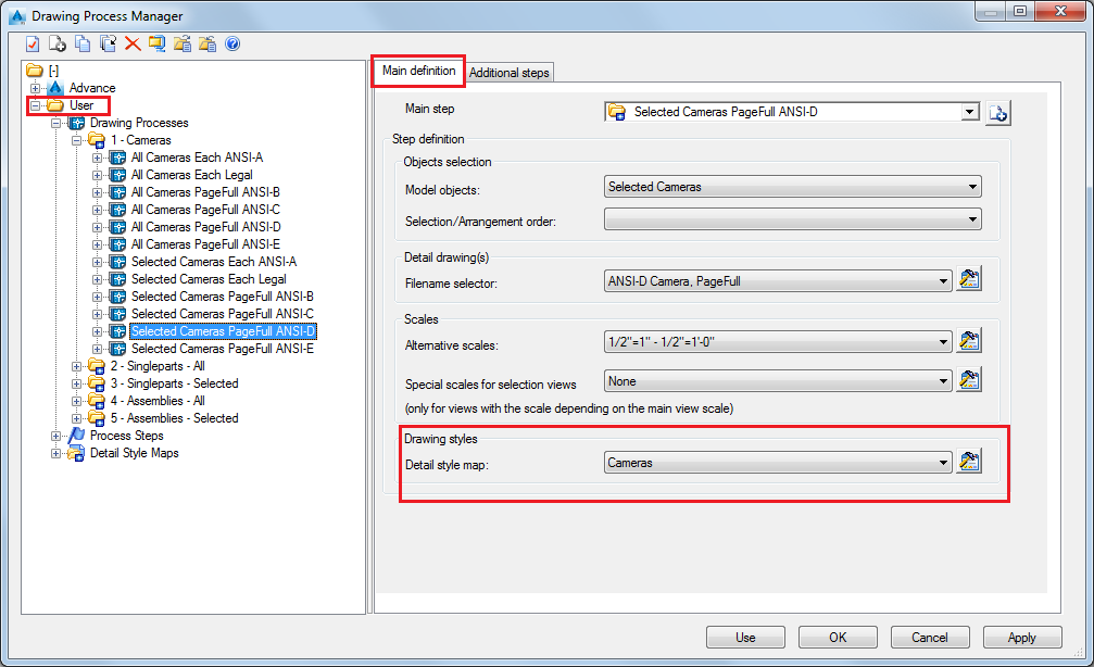

You can create a view, using a drawing process from either the Drawing Processes Palette or from the Drawing process manager.

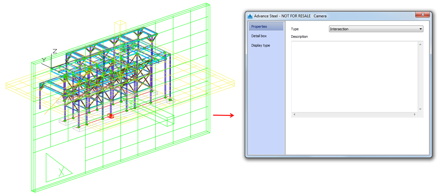

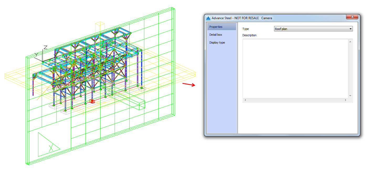

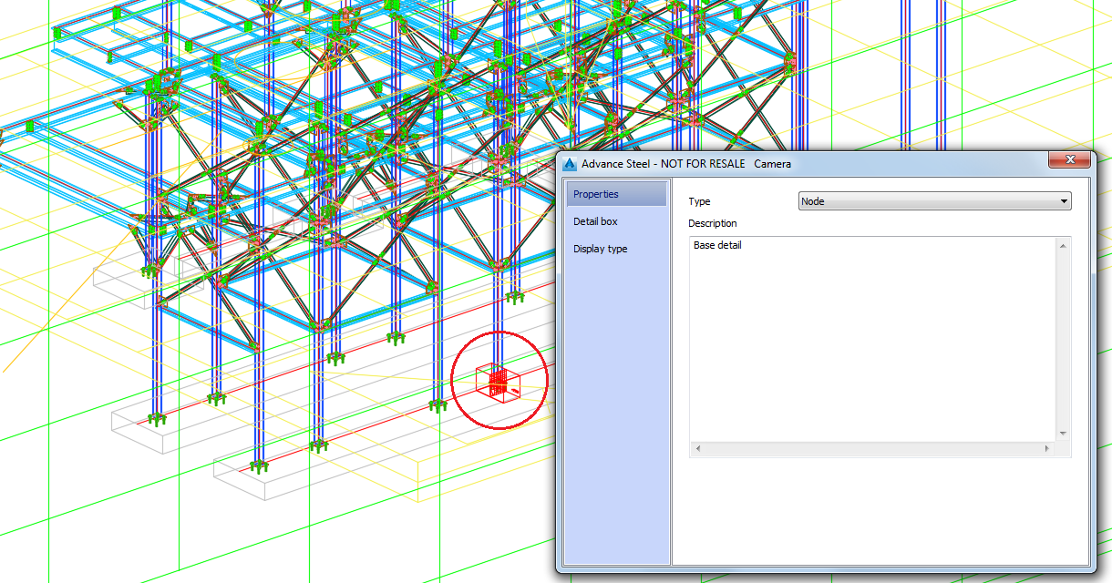

In this example, there are three cameras, each with different properties, set in the Camera dialog, Properties tab, Type field:

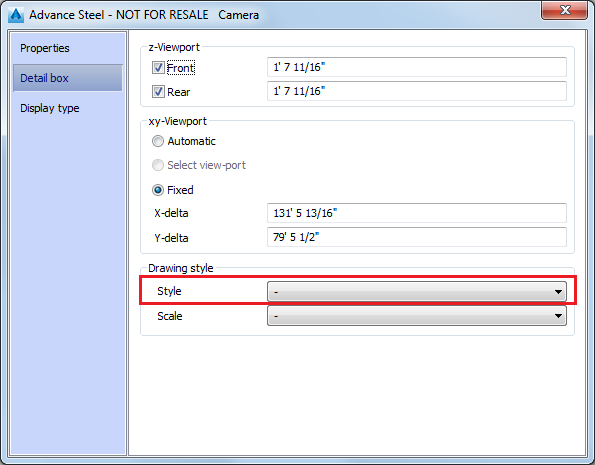

Also, none of them has any drawing style set in the Detail box tab, Drawing style section, Style field:
Drawing process manager, in the
Output tab,
Document Manager panel.

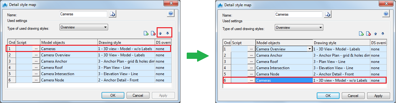

(Properties) icon on the right of the drop-down menu to see the
Detail style map of the current drawing process.
The drawing styles for cameras used in this process for:

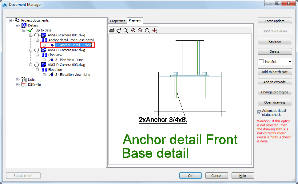

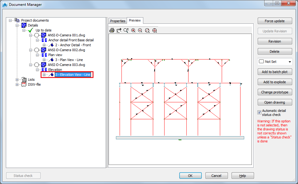

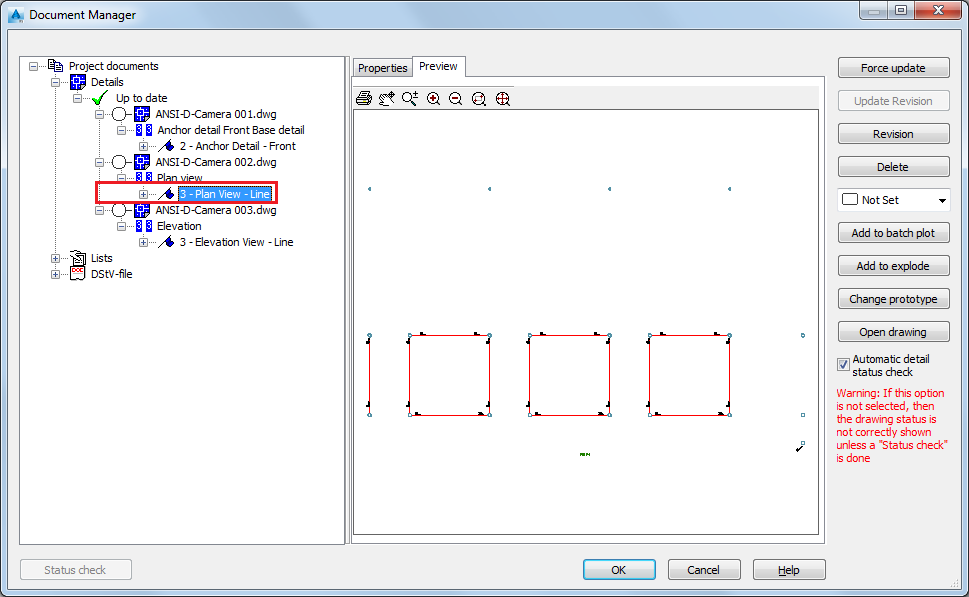

(Document Manager), from the
Output tab.

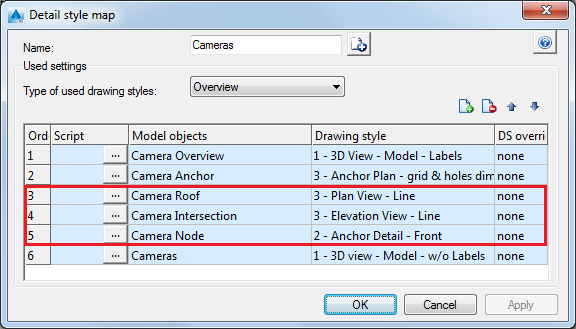

Your camera details are created using the drawing style set in the process detail map, for each type of camera:
