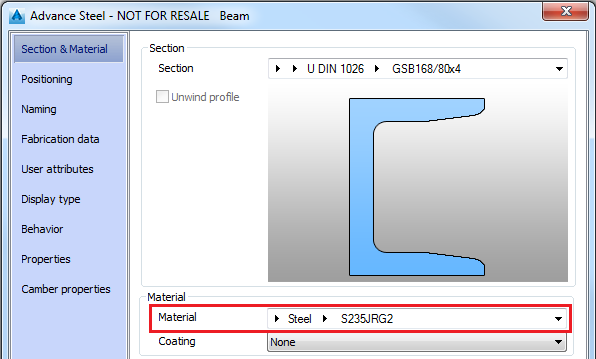

After creating an element, the material can be modified in the properties dialog box. If all the selected beams are made out of the same material, then the material field is editable and the modification is applied to all the selected beams. The same thing happens if, instead of beams, all the plates are selected.
In a regular model not all the beams and plates can be edited because these elements are created by joints and the material is taken from libraries.

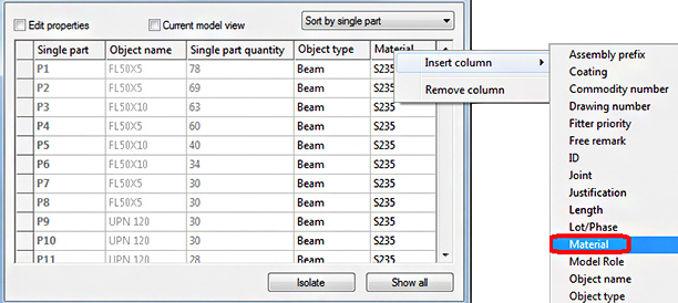

To insert a new column, right click on the table header and choose one of the properties to display, in this case, material.
By clicking on Material, the properties from the table lines are rearranged according to this selection.
To modify the material for one element, select Edit properties.

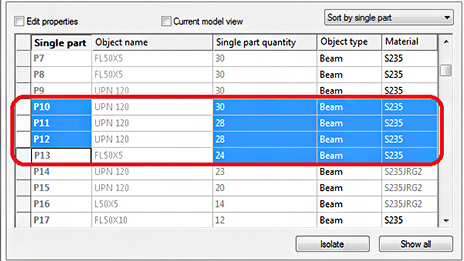

To modify the properties for several elements, select the lines using the key for selecting successive lines (SHIFT + arrows) or the key to select random lines (CTRL + click), then right click on the model and access Advance Properties.
