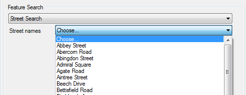

Using Feature Search, you can quickly find the location of a certain object, such as a building, parcel, or any other industry model feature that has geometry. The detected geometry becomes the center of a graphic generation or a zoom Go To.
Feature Search is based on search definitions that can be arbitrarily defined. The definitions are stored in the industry model in the system table TB_POSITION_FINDER. That means that you can define special search definitions for each industry model.
Both Conjunto de ferramentas do AutoCAD Map 3D and Infrastructure Application Extension use Feature Search to generate graphic using geographical selection.
In the Feature Search group box, you can specify a map center by selecting a certain object. The searches can be defined with the Feature Search Administrator. This search is of the search type sequential with input type combo box.
