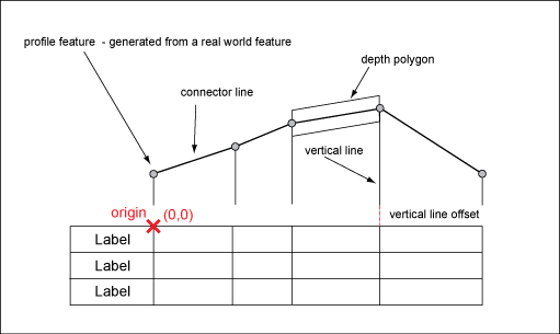

Profile feature classes store the points, lines, and labels for each profile. Profile feature classes represent two types of features:
A real world feature (parent), such as a manhole cover. Each real world feature corresponds to a profile feature. Real world features are profile objects that are normally displayed in the global reference system. The profile feature class stores the relation to the real world feature in the attribute FID_PARENT.
Decoration elements of the profile drawing, such as frame lines, legend, and fix labels. Decoration elements do not correspond to any real world features.
For example, a profile feature of WW_LINE_PRO stores the profile line that corresponds to a real world feature of WW_LINE.
Use the Data Model administrator to create the profile feature classes. Usually you have one corresponding profile feature class for each real world feature class. The following table is an example of how a wastewater profile could be stored.
| Profile component | Profile feature class (example) | Level of detail |
| Network line | WW_LINE_PRO | detail |
| Network point | WW_POINT_PRO | detail |
| Feature label | WW_LINE_PRO_TBL WW_POINT_PRO_TBL |
sub detail |
| Vertical line | WW_PROFILE_LINE_PRO | detail |
| Connector line | WW_PROFILE_LINE_PRO | detail |
| Symbol such as origin, reference height | WW_PROFILE_POINT_PRO | detail |
| Polygon | WW_PROFILE_POLYGON_PRO | detail |
| Static text such as height, legend labels | WW_PROFILE_STATIC_TEXT | detail and sub detail |
