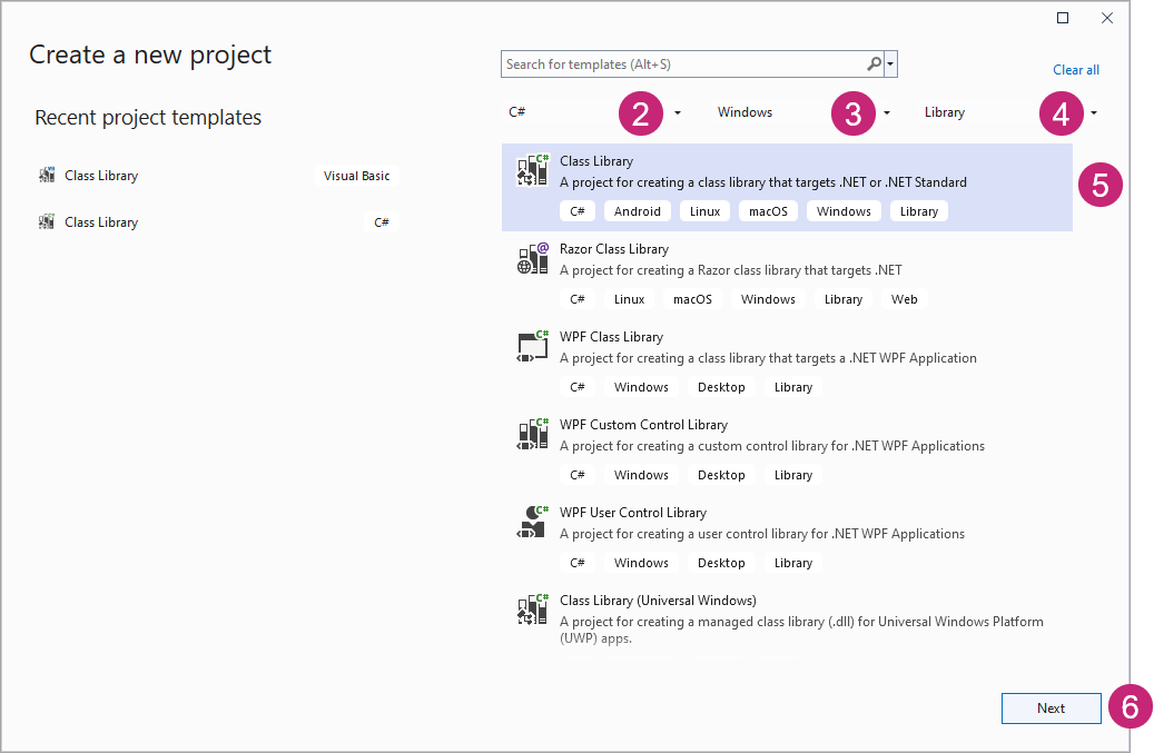

- In the Create a New Project dialog box, from the Language drop-down list, select C# or Visual Basic.
- From the Platforms drop-down list, select Windows.
- From the Project Types drop-down list, select Library.
- In the Templates list, select Class Library - A project for creating a class library that targets .NET or .NET Standard.
To utilize forms in your application, Select WPF Class Library - A project for creating a class library that targets a .NET WPF Application.
Warning: Make sure to not select the Class Library (.NET Framework) or Class Library (Universal Windows) template.

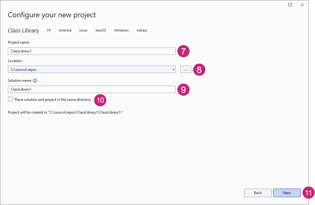

- In the Configure Your New Project dialog box, click in the Project Name box and enter a name for the new project.
- In the Location box, enter a location or click Browse to select a folder for the new project.
- In the Solution Name box, enter a name for the new solution that the project will be added to.
- Optionally, clear the Place Solution and Project in the Same Directory check box to create a sub-folder under the solution for the project.
- Click Next.

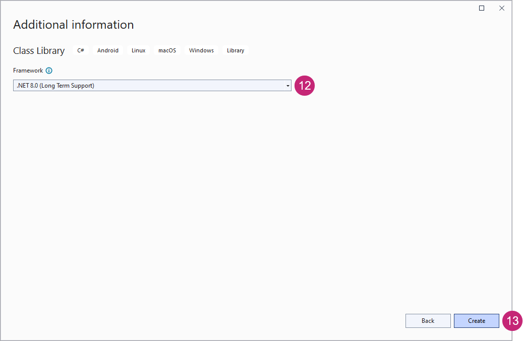

- In the Additional Information dialog box, from the Framework drop-down list, select .NET 8.0 (Long Term Support).
- Click Create.

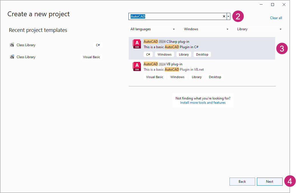

- In the Create a New Project dialog box, click in the Search box and enter
AutoCAD.
- From the Templates list, select AutoCAD <release> C Sharp Plug-in or AutoCAD <release> VB Plug-in.
- Click Next.

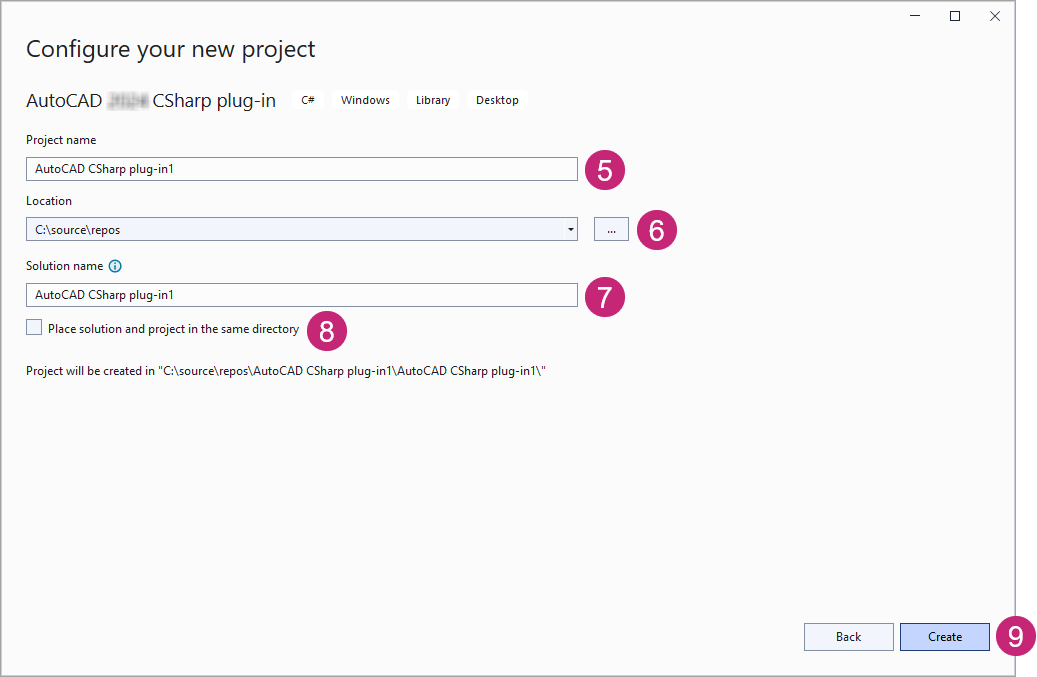

- Click Create.

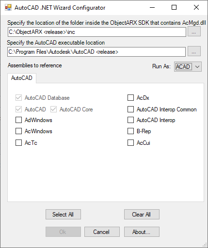

- In the AutoCAD .NET Wizard Configurator dialog box, specify the libraries to reference to the project.
- Click OK.
